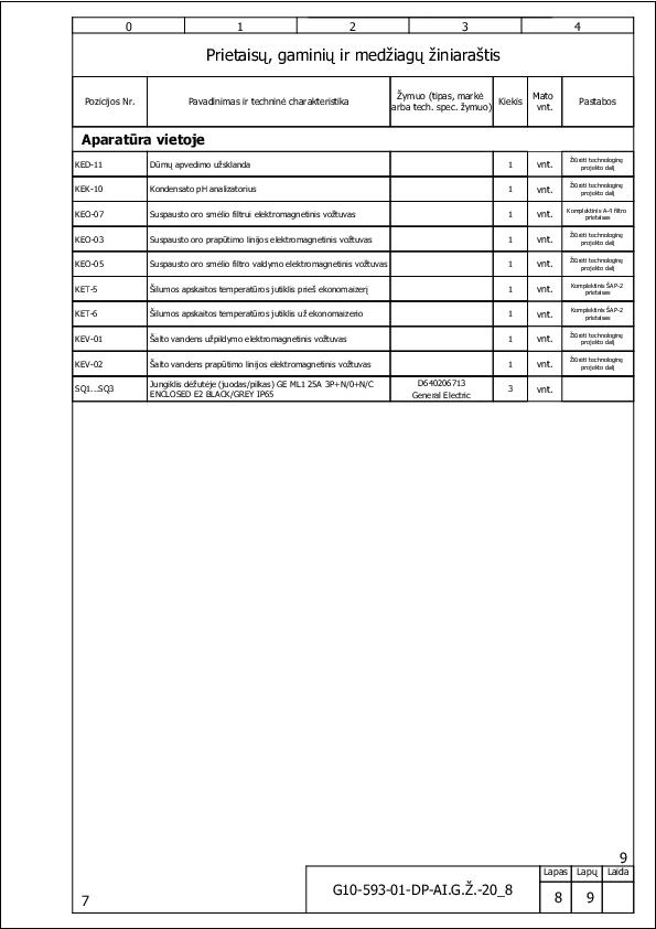

EPLAN Electric P8 : Forms
LaurasM am 13.01.2011 um 08:34 Uhr (0)
Hello, EPLAN Electric P8 fans. I have 2.0 version and recently faced with a problem of one form…1) I want to generate a form that will sort parts according to the manufacturer, for example:***************************************************************************manufacturer1 Part name .............. quantyti...............price ............... etc.. . . .manufacturer2 . . .***************************************************************************EPLAN have th ...
LaurasM am 14.01.2011 um 09:13 Uhr (0)
Hello!Thank you for your interest in my problems. Ive made atachments:first Eplan print job containes 2 pages made with a form F02_ElintaVS_rusiuoja_pagal_spinta.f02 (delete .txt index). This form makes to diferent pages according to "Mounting location". Id like it to continue sorting on one page. (it all made in my local language Lithauen) second Eplan print job 1 containes the drawing and the part list for that drawing it all made by Eplan 21. How to make it on Eplan P8 2.0v? Explane me step-by-step. Tha ...
